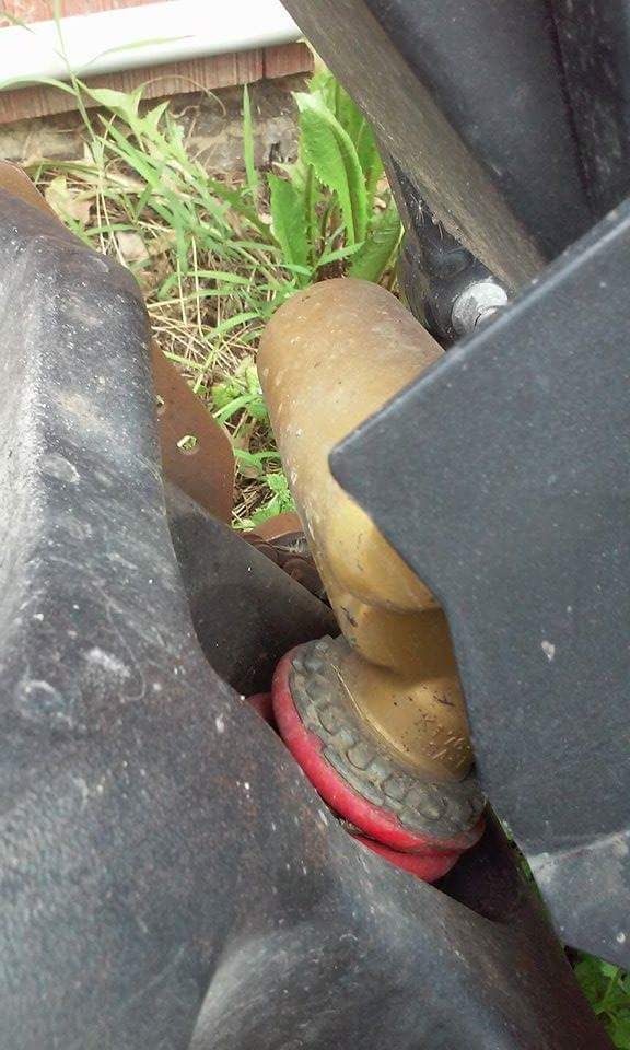

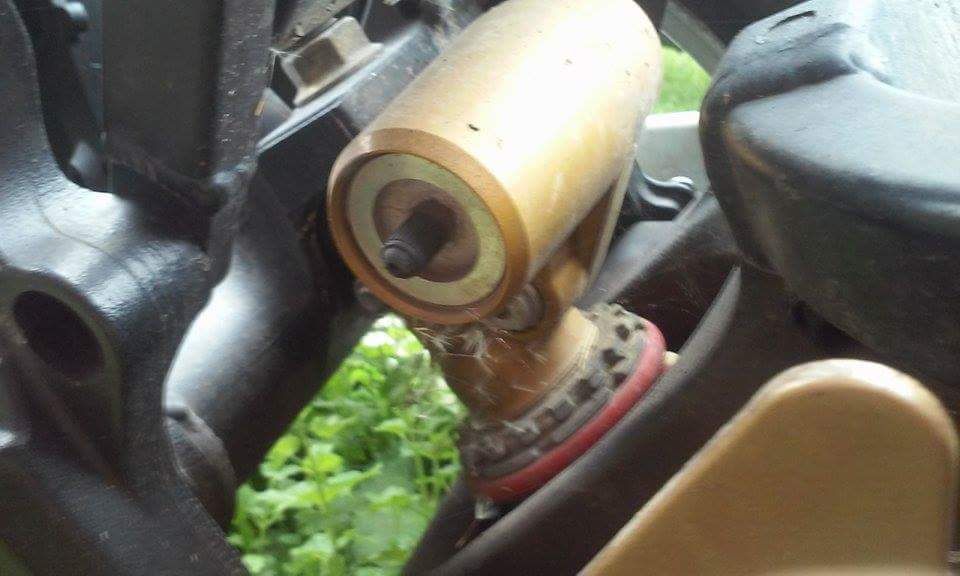

#10 · (Edited)
For hayabusa shock: 1999-2007. if you're lucky and it comes with the linkage (that bracket on the right side of the pic) you can move the 10mm bushing over and not have to drill out the shock to accept a 12mm bolt.
