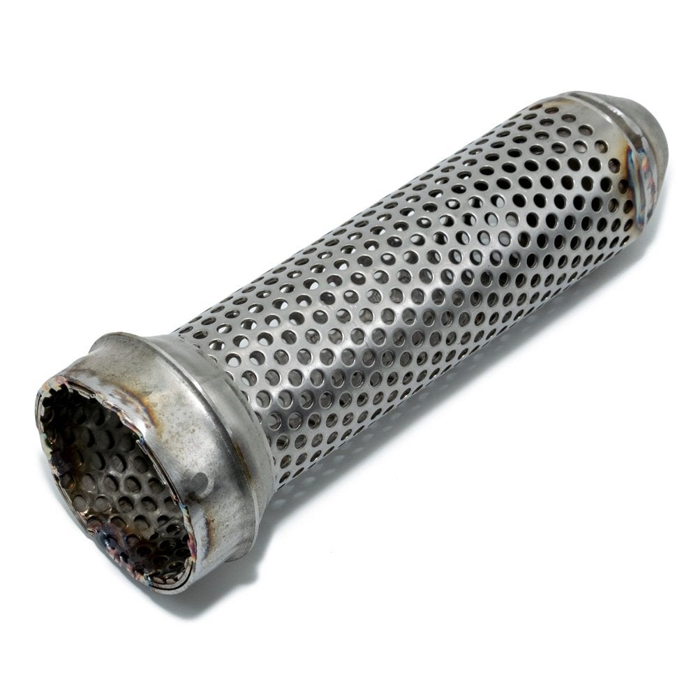

It'd probably be simpler to use a dB killer like the Leo Vince as a replacement for the Dominator one - something similar costs US$7 here. And you could do both :) I'm not happy with the Dominator one either, certainly in stock form.
The cheap ones that need modifying:
Household hardware Font Auto part Cylinder Circuit component
The Leo Vince design:
Automotive tire Office supplies Cylinder Auto part Rim
If that reduces noise without affecting performance, yes I believe I could start with that.
The dominator DB killer reduces the can's exhaust diameter and I think that's why it reduces performance. It limits the exhausts flow.

Hey Dante,
Just tried the LV imitation - works very well as a replacement for the Dominator - throttle feels a little more lively esp at 5k going into 6k when the party starts. Sounds better - it is about the same at idle but noise picks up with throttle much more so it is louder on the highway and blasting up a mountain road. It also sounds more bassy - more lion and less hornet than the Dominator db killer. Definitely worth a try to see if you like it. They are available on Aliexpress and Ebay if you cannot source one locally.
I cut 9mm off the mounting ring and cut the end cap off, like this:
Office supplies Audio equipment Cylinder Auto part Metal

My experiments with db killers is done at last - the one above is the best. It's not the quietest but offers low enough noise for trickling through the village near idle speed, and yet gives a great bassy sound and, most importantly, good throttle response when riding.
I tried cutting down the Dominator and the results were reliably predictable. Shorter pipe, less restriction, more noise. The slash cut mixed the tone. The shortest length is now 60mm and the longest is 90mm.
