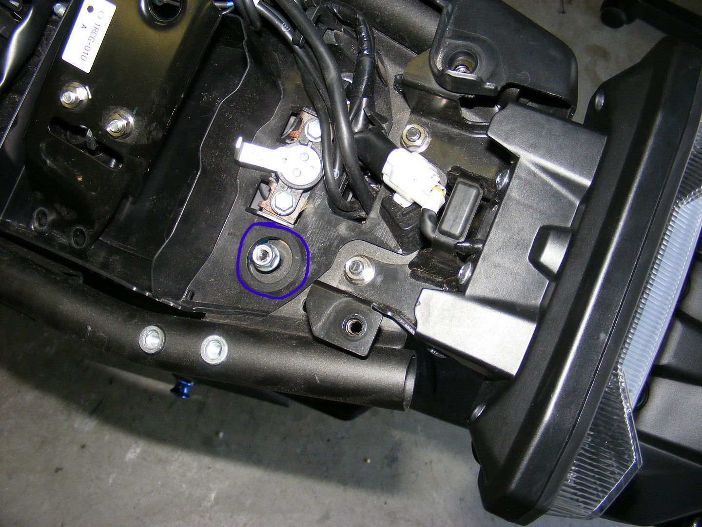

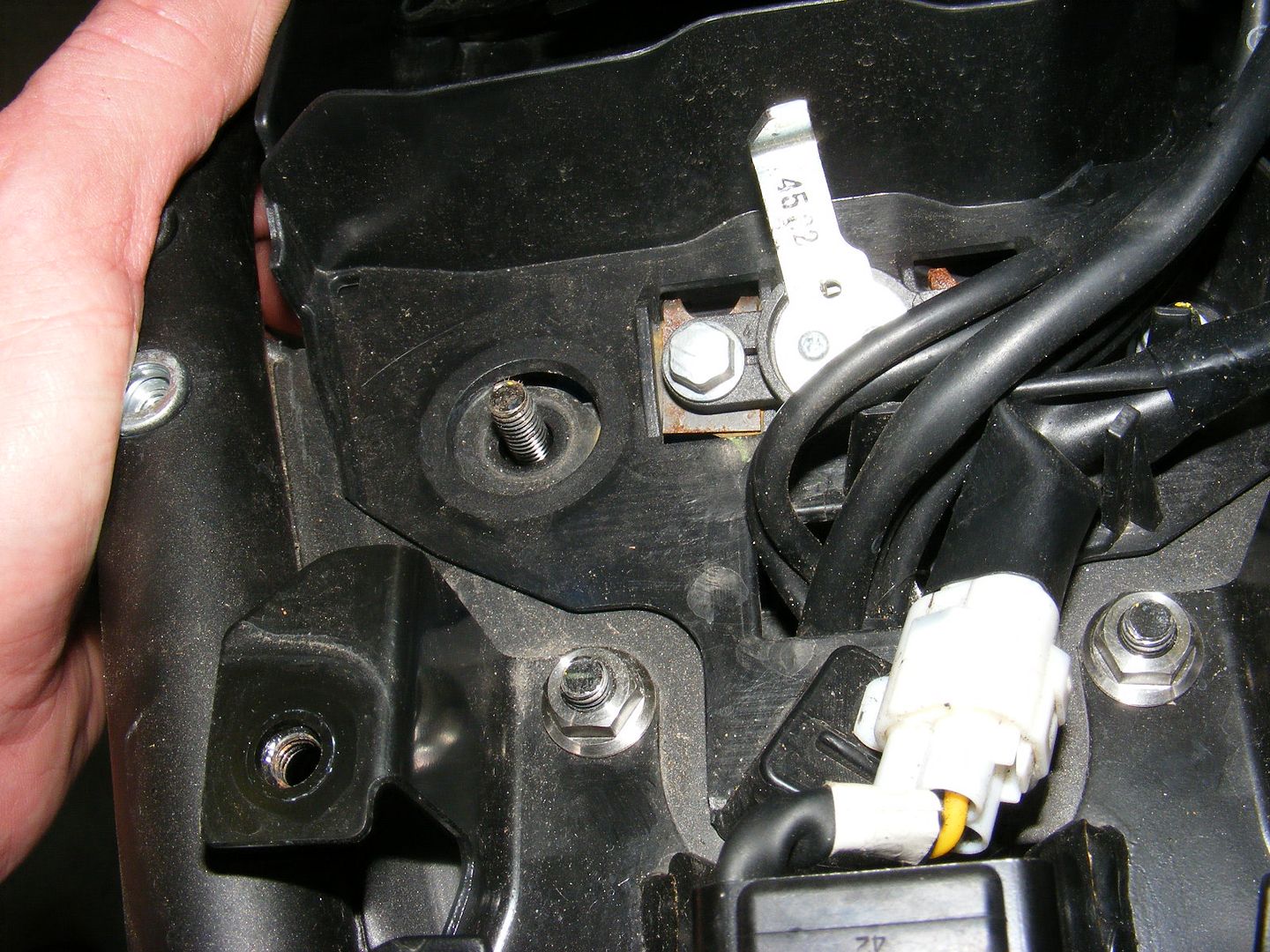

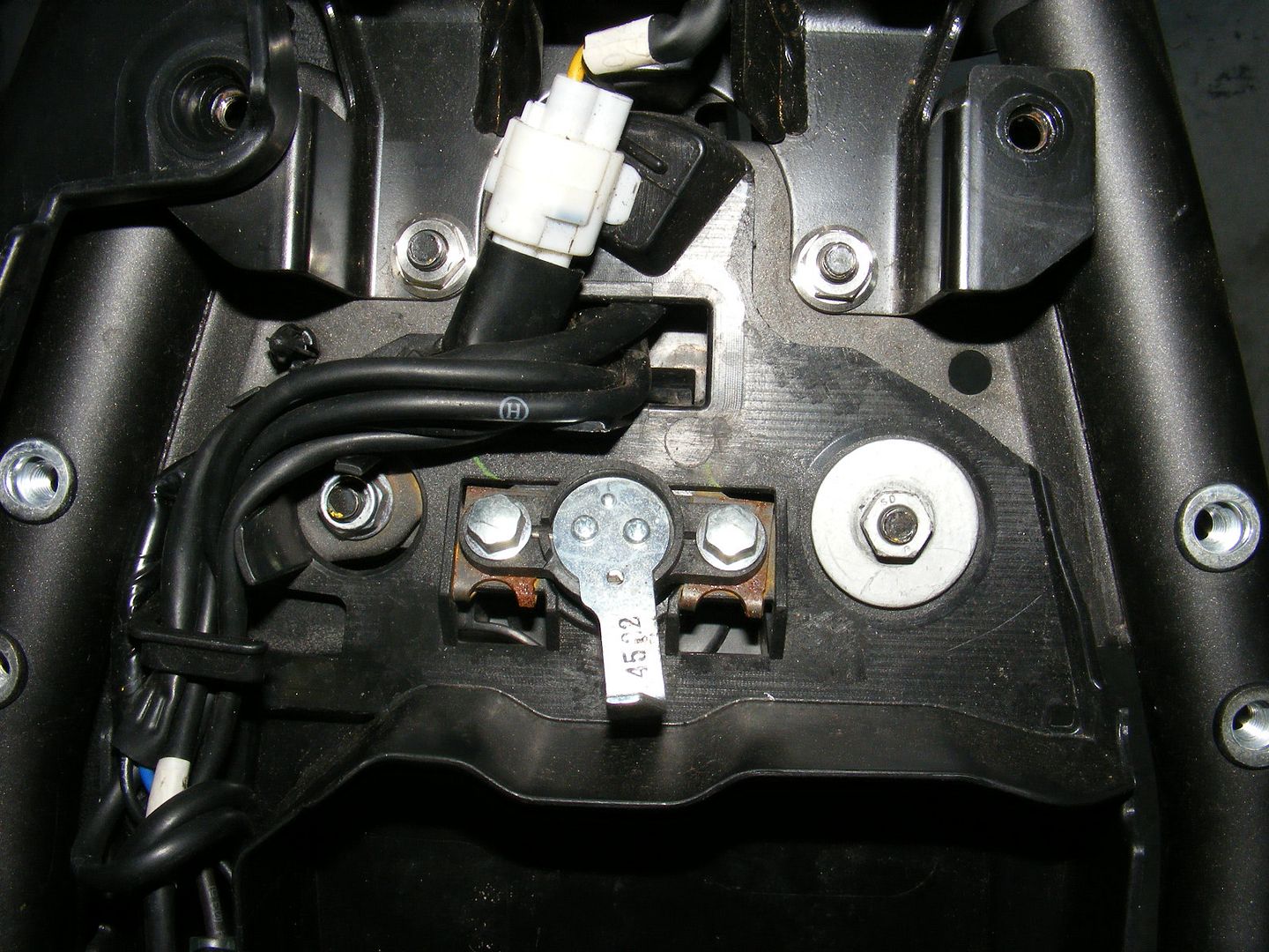

I also have found of late when trying to unlock the seat I find I am able to push the key barrel upwards & it is missing the arm on the seat release latch, looking at the problem with the seat removed I could see the whole under tray can be lifted if the key barrel is pushed upwards & it misses the seat latch lever, my fix was a penny washer to hold the tray down problem all gone now.
This is the problem area that can be lifted up & miss aligns the lock & catch.
There was no washer securing the parts together.
My solution fitting a penny washer.
