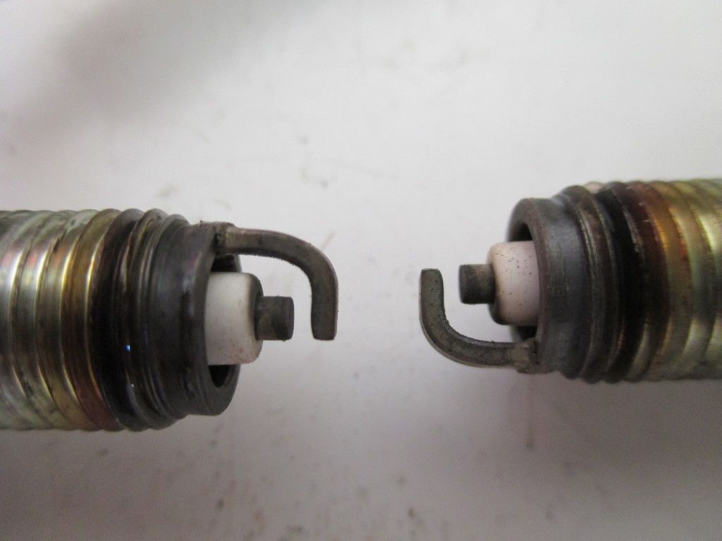

Like most others replying to this thread, you only need to change the plugs if they are eroding away.
This picture is of the plugs on the FZ at 5K miles. If you look closely, you can just see some rounding off on the center electrode and a little bit of tapering of the ground wire at the open end. Looks like the erosion is slow and these do not need to be replaced.
Some coil packs are harder on plugs than others
[URL=http://s38.photobucket.com/user/RichBinAZ/media/My%20Bikes/IMG_0970_1.jpg.html][/URL]
