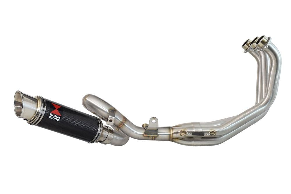

#279 ·
2 dB killers looks interesting - I wonder what designs they have for them. I couldn't find any pics - did you?
The headers look like they are very long with no balance pipes so the scavenging effect will be very different from stock?
One of the reasons for liking the Leo Vince is that they have emulated Yamaha's short 3-into-1 headers so scavenging will be about the same - seems to be the design that least needs a dyno re-tune, along with the Akra iirc.
#281 ·
Pics of the dbkiller I did not find.
Regarding the header desigg I cannot really comment if it would need a retune more than another full system.
I would regardless of exhaust choice get the MT09 tuned.
Maybe @ Vcyclenut can comment as this design seems similar to the spark exhaust.
