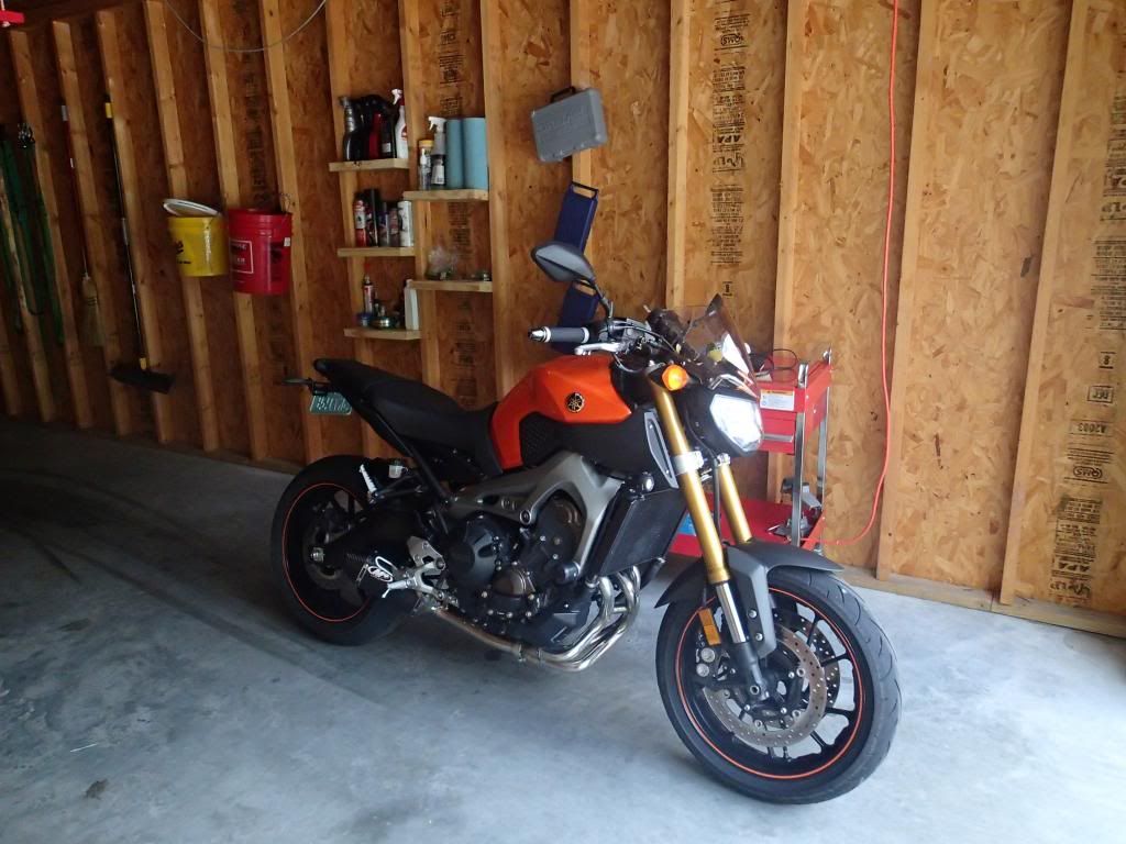

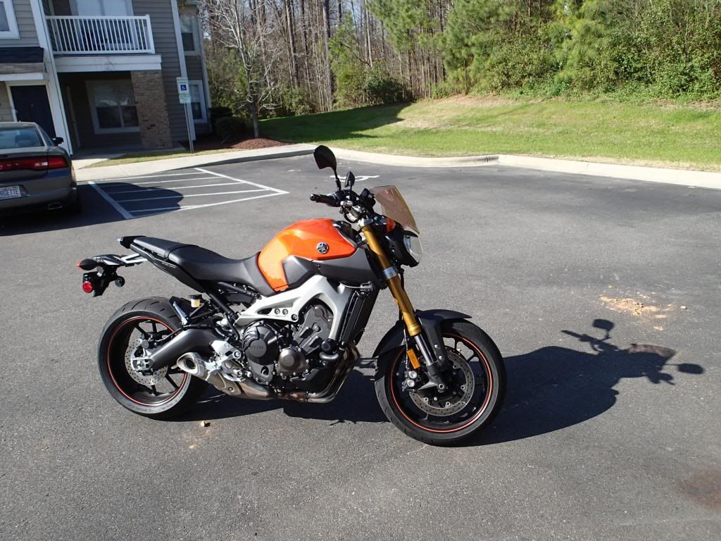

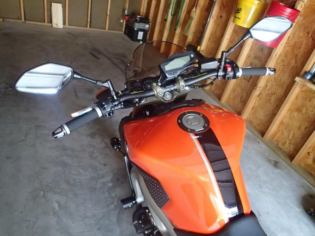

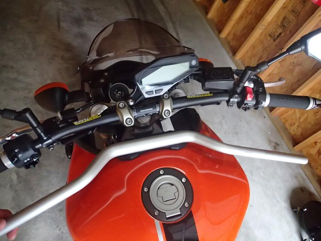

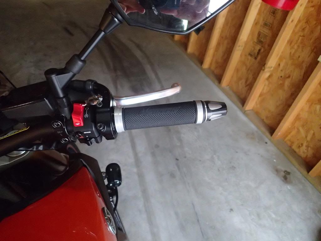

A big thanks to Marthy for sending me the info on these! They were sort of a pain to install but these bars feel so much better than the stock bars without going to the extreme of the clubman bars. It drops them just enough so that im leaned over at not clinging to the bars when accelerating. Paired the bars with Driven grips and bar ends as well.
Here is before
And After

They are the Pro Taper Carmichael bars, I just picked mine up off amazon for like 60 bucks. The biggest PITA I had was the left side mirror, the new bars have a knurled section for the grips and with the clamp for the mirror base all the way loosened the bar would not pass through due to the bigger diameter of the knurls. I ended up having to take a dremel to the inside of the clamp to open it up enough to get it over the end. You also have to take a dremel to the locator pin on the headlight controls and stop/start switch, unless you want to drill holes for this. I ground mine down enough so that it just clamped on the bar

I knew about grinding the control pins but completely forgot about the clutch clamp. I had to wedge a screwdriver to spread it a bit more to go over then clamp it with pliers after to put the bolt through. Sorry about forgetting about that...
But she looks sexy now with those bars! Perfect fit hey.

Even with a screw driver I couldnt get mine to slide over, but a simple fix and worth the hassle
