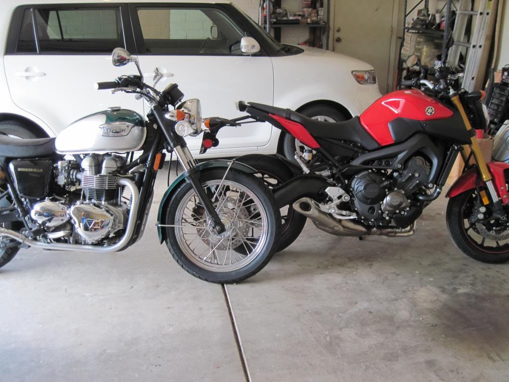

I have no idea what the coating is... It may be as simple as a passivation process, which does make some stainless better at resisting salt spray, or it could be something added. My Bonnie has stainless pipes that started out looking nice, but blued very quickly. They went thru all the colors of the rainbow and ended up a dull grey up near the head.
I didn't really like that color change so I got them Jet Hot coated silver, back when they had a plant in Tempe. Not seeing it on their website now. The pipes retained their silver color although they have dulled a little over the 12 years I've had the bike. That could be a low maintenance solution for you.
Here is their maintenance tips. I agree about never using an oven cleaner. I tried that to get of some melted plastic and it messed up the finish.
They have a stack of colors now - very interesting. To do our stock pipe, they would have to plug up the pipe so it wouldn't mess with the cat converter, which may or may not be tricky.
I remember seeing a car intake manifold they had done in matt black and put in their showroom. It just sucked up the light - couldn't really tell it had a shape.
My Bandit pipes went a nice shade of gold, which I thought looked good, so I never polished them off. If the FZ does that, it won't be so bad.
1,081 Posts
The Triumph is gorgeous. They look like the same bike, just one from way back when and the other from the future!
