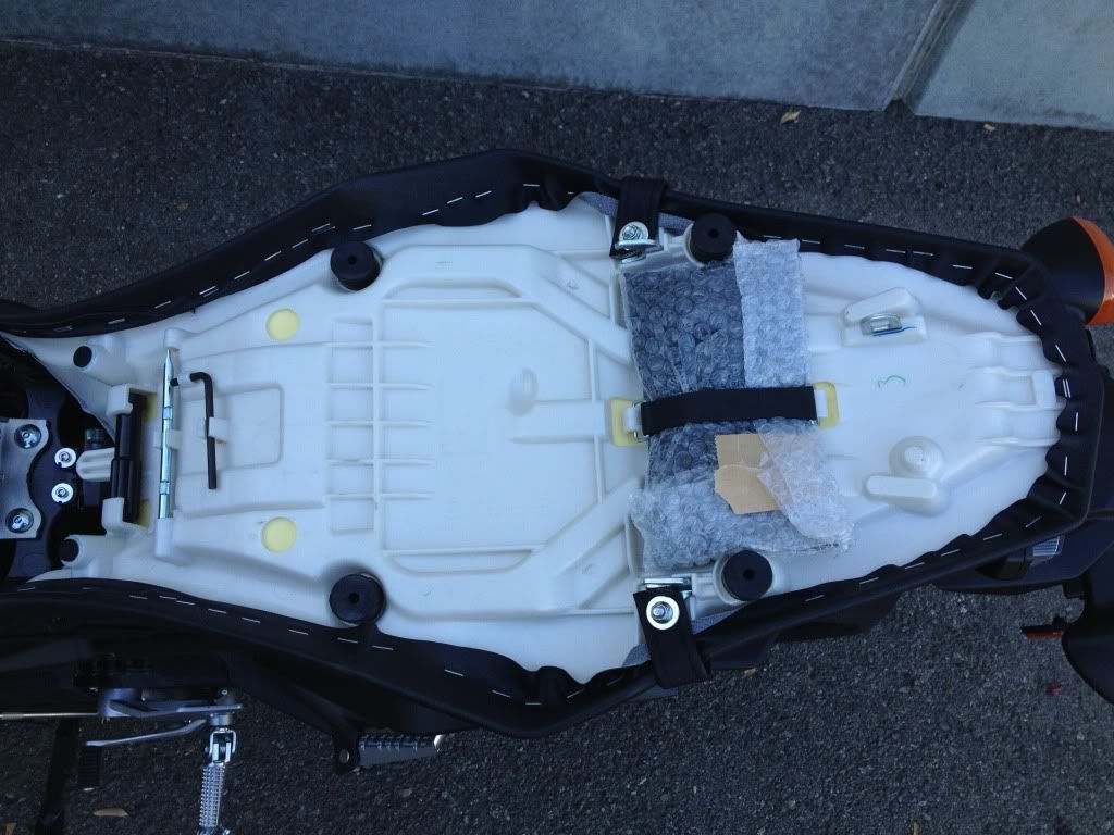

I read on another Forum that some owners did receive or didn't receive the additional toolbag that the bike comes with. The toolbag includes a spanner wrench with 12 & 14mm ends and another spanner to adjust the pre-load on the shock. Unfortunately the tool bag doesn't fit that well in the storage tray under the seat. However if you use the rubber strap that came with the tool kit you can secure it to the underside of the seat shown in the picture below. If you look at the plastic base for the saddle, you can see closely that Yamaha designed it to hold the tool bag there. I stored my registration / insurance info in there and also left it in the original bubble wrap to help prevent moisture penetration. Although I may switch to a zip lock bag later. Now I can store other items in the storage compartment such as a wheel lock etc.
Also, I noticed there seems to be another smaller tray in front of the battery under the gas tank. Not sure how secure it is, but I think its worth investigating.
Reactions: eolith

That tool kit is pretty lame really. I noticed it does NOT come with a spark plug wrench and the manual says to change the plugs every 8K miles
The back 2 rubber bosses that rest on the frame sit very close to the painted (red) side covers, you might want to be sure the "kit" doesn't rub the color off those pieces.

I'm pretty sure there's more tools on the bottom of the seat. Not under the seat, but actually stuck to the plastic seat base.
