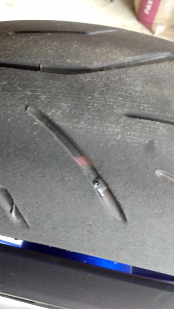

Hey all. After a ride this past weekend I noticed I had a nail in my rear tire when I got home. It was a fairly small nail, about the size of a small needle and was bent in half with only half of it actually in the tire. I removed the nail and could not hear any hissing from air being lost. Its been a few days now and the bike has sat parked in my garage... I haven't had a chance to check my tire pressure but from a visual inspection the tire seems to have not lost any air.
A very small bubble formed in the tread after I removed the nail and as a temporary patch with what I had available, I put a dab of gorilla glue over the hole (the dab you see in the pictures covers more area than the puncture itself which was small). My question is, judging from the pictures, does it look like something I can just get professionally plugged/patched? Or am I out for a new tire? I'm hoping to just get it patched up since I only have 900mi on the tire.

In the picture, the nail looks to be in a wear indicator. Is that the bubble you refer to?
Rotate the tire looking at the tread and you will see more like it. That is, if I am seeing what I think I see in the pic.
While not ideal, I have patched a few tires from inside with no issue....If there is truly a bubble then I wouldn't consider a patch of any kind.
You actually hit the nail (no pun intended) on the head. I haven't had a chance to update this thread but it turns out, you are correct, it is a normal "bump" or tire wear indicator as you say, in the tire. I checked the rest of the tire and those bumps are a normal part of the bridgestone battlax s20 tire... it does not appear to be a bubble like I originally thought. Additionally, I haven't noticed any air loss since I started the thread and I've been checking it every day. At this time I think everything is OK and it did not do any damage or cause a deep enough puncture to leak air.
Pic of where I pulled out the nail:
Pic of another part of the tire showing the same bump:

Look along the sidewall of most tires and right where it meets the tread are regularly-spaced "markers". Some are simply little triangles, Michelin has even used tiny "Bib" guys. LOL
Logo
They may even have T.W.I. beside them depending upon the brand.
Anyhow, follow directly across the face of the tread to the nearest groove and you will find a tread wear indicator "bump" down in a groove like you see in the above photos. I'd peel the gorilla glue off, inflate the tire to 45psi, apply soapy water and wait. No bubbles? No problem. Bubbles? Get a tire. After watching a new Metzeler nearly cut a nail in half within 5 miles, I don't trust a plug in a radial tire more than it would take me to get it home. My $0.02
