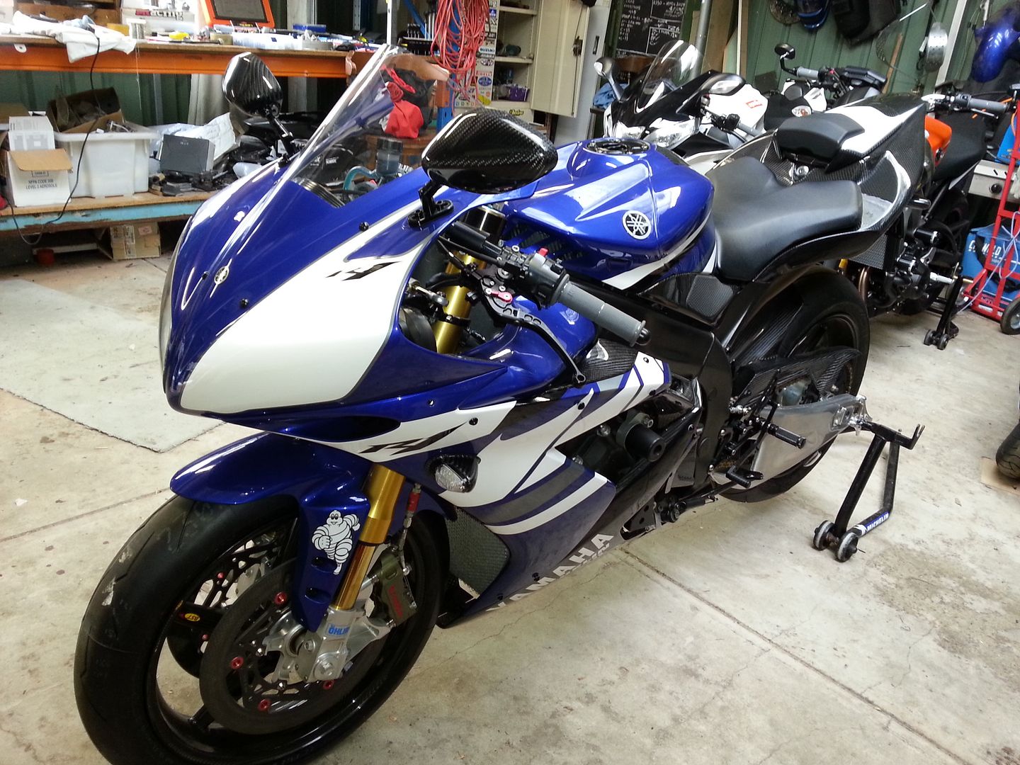

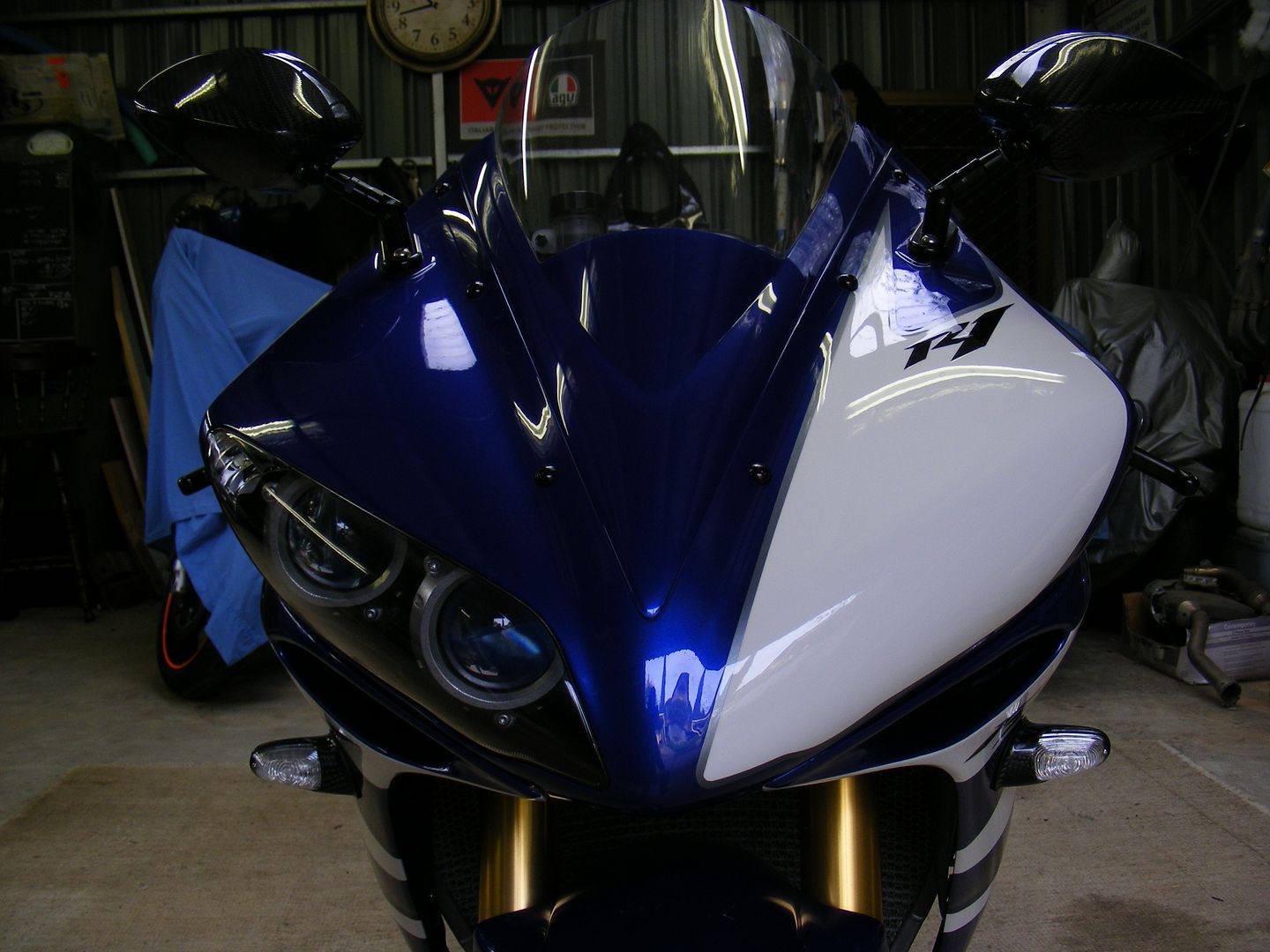

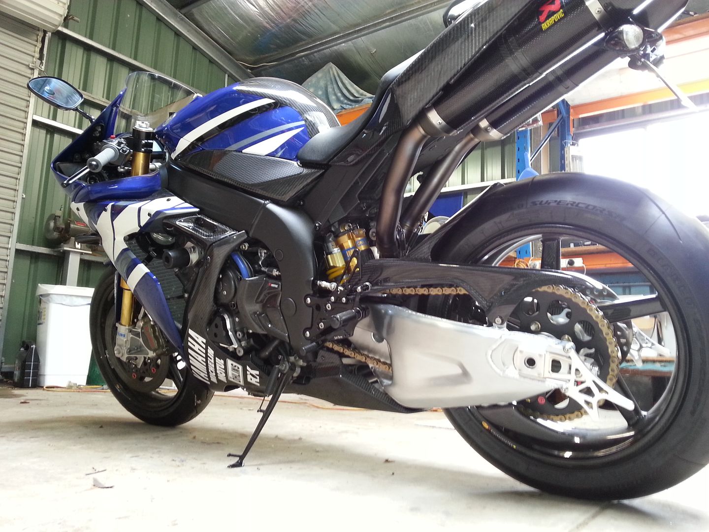

I bought this 06 R1 new and I've been tweaking it ever since. It's a long term love affair, and there isn't much of it left unmodified. I love racebikes of all kinds, but the World Endurance Championship machines have always grabbed me the most. I've built GSXR's, a ZXRR and a couple of CBR's into endurance styled bikes, with single offset headlights and race parts. But this one is a bit special. I'm rebuilding it after a lowside at high speed, and it's not quite complete...but I fitted the freshly painted bodywork today and I'm stoked with the result. I hope you like it. :D

And here's a short list of the modifications so far...
ENGINE
Ported and polished head
Reshaped combustion chambers
Kent Performance Race camshafts
Skimmed cylinder block
YEC hi comp gasket
STM EVO slipper clutch
Graves velocity stacks
Akrapovic Ti Evo full system
Akrapovic slash cut CF mufflers, shortened 50mm
BMC race air filter
K&N oil filter
SBP custom dyno tune and map
Removed/bypassed air induction system
Robby Moto Eng. quick action throttle
Bora SBK race radiator, with OEM fans fitted
SFS sillicone coolant hoses
Custom radiator guard
Rizoma oil filler cap
Ti magnetic sump plug
ELECTRICS
YEC ecu
Dynojet PC III usb
Translogic quickshifter
Shorai lithium battery

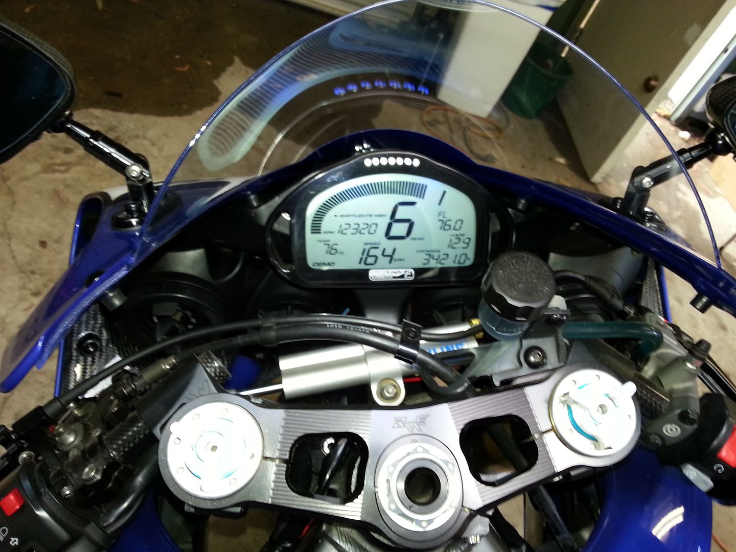

Translogic digital race dash
Translogic shift light
Manual fan switch wired to hazard light button
Translogic dash function switch wired to headlight flash button
Magical Racing carbon indicators
Graves exup eliminator
Accumen LED flasher relay
Custom twin projector headlight
Ignition barrel relocated to empty headlight shell
A&R 4300K HID kit with LED parker light
Narva 4300K high beam
Narva 90db forklift beeper
SUSPENSION & CHASSIS
Ohlins FG43 road & track forks
Ohlins .95kg springs
Ohlins SBK fork internals upgrade
Slingshot Racing prelaod adjusters
Ohlins steering damper
Robby Moto Eng. damper clamp
Woodcraft clip on clamps
MW carbon fibre handelbars
Robby Moto Eng. ergal adj. offset triple clamps
Evotech top yoke nut
CRG supersport clutch perch and lever
Renthal soft grips
Ebay rubber frame plugs
GYTR delrin frame protectors
Agras engine case protectors
Sato Racing rearset footpegs
Ohlins twin speed shock w. hydraulic preload adj.
Graves superstock shock revalve
Ohlins .95kg spring
Renthal/Driven sprockets 16/48
RK GXW 520 race chain
Harris kit WSBK fully fabricated kit swingarm
Harris Chain adjusters
Harris captive rear caliper hanger
Harris GP style lifters
Harris rear axle
Harris CF shark fin/toe guard
Custom machined axle cups
BRAKES & WHEELS
Blackstone Tek carbon wheels
Brembo HPK 108mm billet calipers
Pro Bolt Ti caliper bolts
Pro bolt Ti front disc bolts
Greggs Ti caliper spacers
Ferodo XRAC pads
Braketech Starblade Ceramic Matrix Composite front rotors
Spiegler quick connect ss front brake lines
HEL custom quick disconnect rear line
ATE super blue racing brake fluid
Brembo RCS 19 billet master cylinder
TWM remote span adjuster
Brembo brake pressure switch
Brembo clear reservoir hoses F&R
Brembo 15ml reservoirs F&R
Brembo HPK billet rear caliper
Brembo underslung caliper mount
Braketech Axis iron rear disc
Pro Bolt Ti rear disc bolts
Graves brake return spring
PAINT & BODY
OEM upper fairing modified for single light
Zero Gravity DB screen with custom paint
Magical Racing type 4 twill carbon mirrors
OEM side fairings, ram air tubes, mudguard & tank
Motoarbo twill carbon fibre inner fairing panels
Pro-Bolt full monnty aluminium fairing bolt kit
Lacomoto M1 style slotted airbox cover
Di Noc wrapped lower airbox
Geelong Carbon Craft twill CF tankpad
TWM quick action fuel cap
Techspec C3 traction pads
Massco twill carbon fibre tank side panels
GYTR twill carbon fibre headlight infill panels
GYTR twill carbon fibre ram air infill panels
I.M. Composites twill carbon fibre side fairing inserts
Dynomite twill carbon fibre bellypan
GYTR twill carbon fibre clutch cable guard
GYTR twill carbon fibre exhaust heat sheild
Magical Racing twill carbon fibre rear hugger/chainguard
Dynomite twill carbon fibre tail fairing
Dynomite twill carbon fibre wrapped OEM underseat tray
Dynomite twill carbon fibre solo seat cowl
Akrapovic carbon fibre sprocket cover
Evolution Composites carbon fibre tail tidy
3M DiNoc wrapped tail light
Raceface Special Paint Finishes custom paint.
Specs. 172 rwhp 170 kg fully wet.

Sweet and sic! Does it run as good as it looks?
Even better! It's as easy to throw left to right at 250kph as it is at 60. It takes off like scalded cat, and the engine revs so quickly I have to be on the ball to change gear quickly enough. It's like ballroom dancing with high explosives! lol
Have you ever raced it?
No, but I've done plenty of trackdays in raceglass. Here it is at Phillip Island. The highest average speed racetrack on the GP calendar. At the end of the main straight you top out in top gear...300kph-ish...go down to 5th, no braking....and peel in to T1. The G-forces at mid corner fix your angle and trajectory. You can't change them so you'd better have it right! :)
Heading up to Lukey Heights....
Mid straight...250kph... 15kg Cape Barren Geese waddling in the background!
Siberia...120kph
Turn 10, just after MG at the bottom of Lukey Heights. Short shift into 3rd....80kph **** all revs...huge lean...no noise. Weird!
(vapourising my leather sliders on ZOOM ;) )
