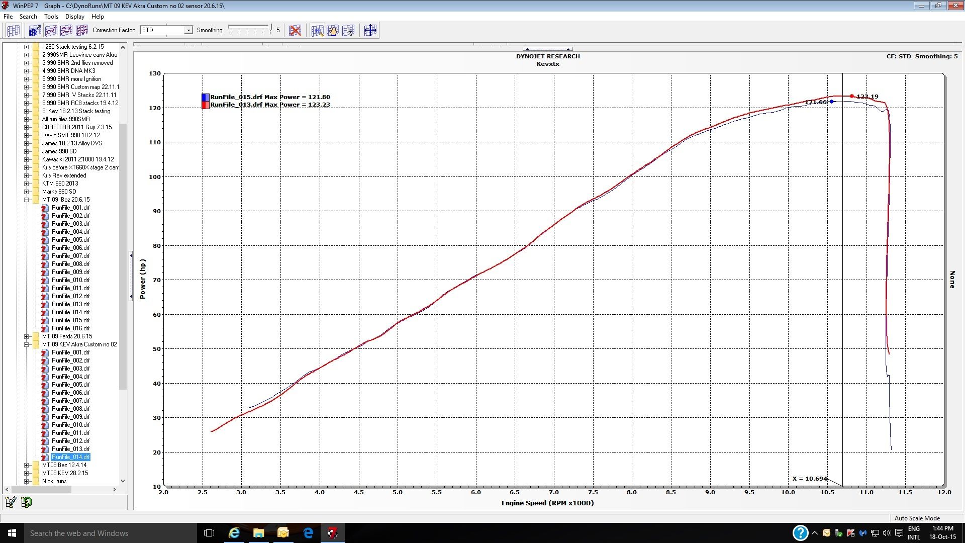

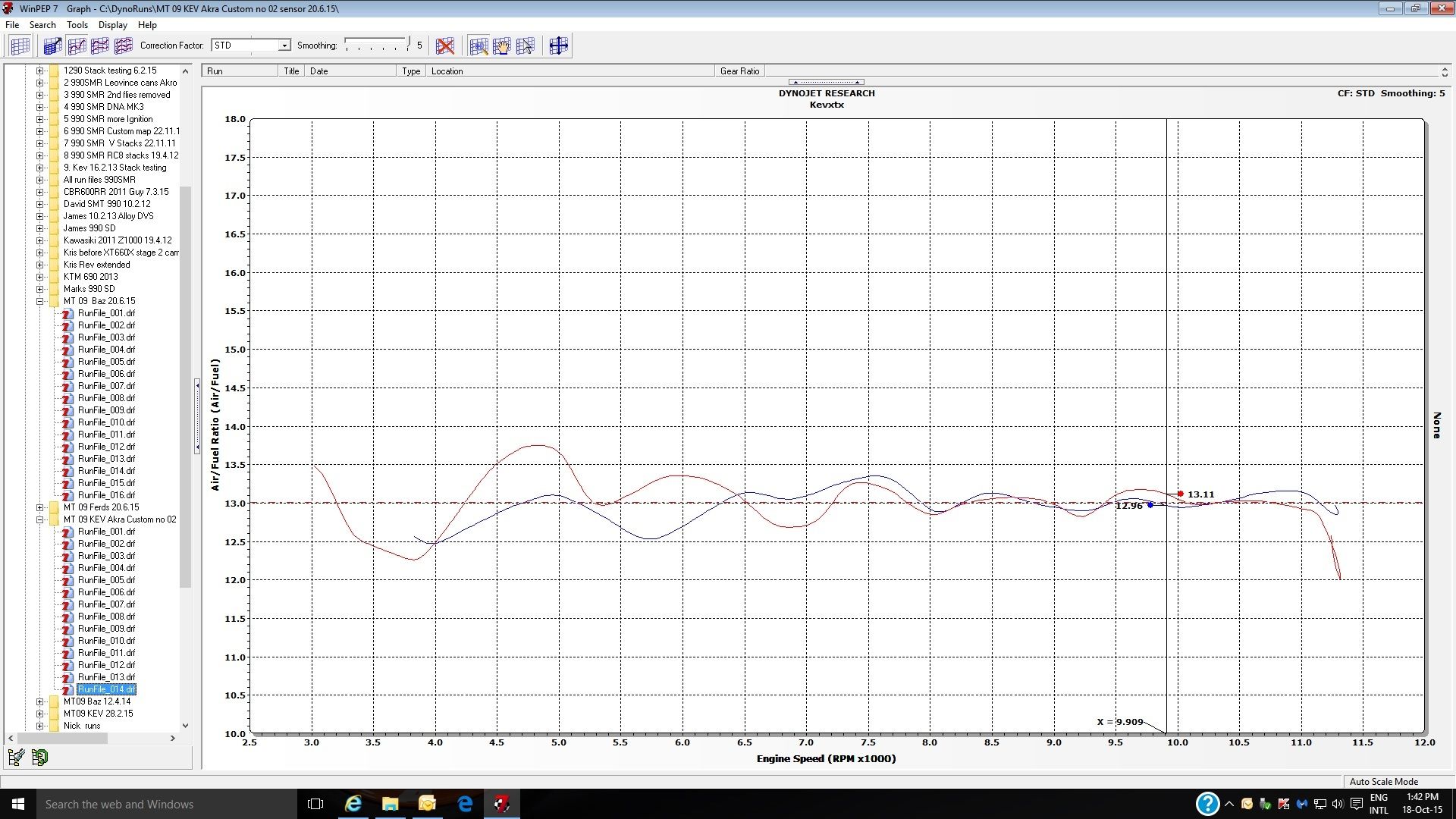

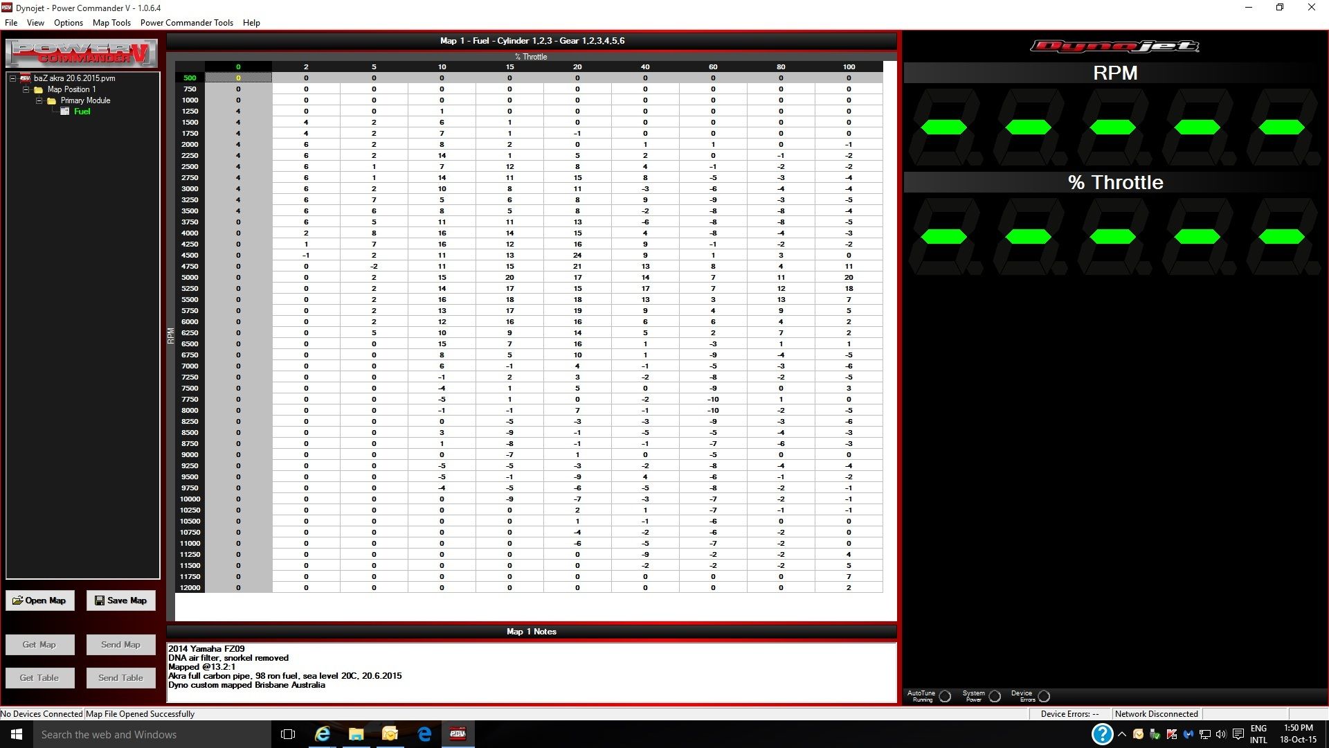

Just uploaded another custom Akra map for you to show some comparisons between tunes, both maps built on the same day, one bike after the other using a PCV & Dyno Tuning software Tuning Link.
BAz bought his 09 in November 2013, mine November 2014, both equipped with the same flash same DNA filter same Akra pipe same snorkel removed, there is around 1hp difference between the two bikes after the tune but the fuel cells are quite different, mine is leaner than his, so the morel of the story is sharing tunes does not mean the A/F ratio's across all the fuel tables are correct for every bike, this is why I spend so much time building custom maps for my bikes for every change that I make that will affect the A/F ratio.
Kev bike RED
Baz bike in Blue
A/F ratio recorded a 100% in the example below.
HP
Baz PCV fuel cells
Kev PCV fuel cells
