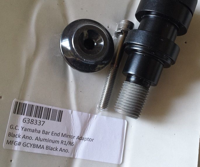

Ordered the CRG Arrow mirrors along with what was listed as Yamaha bar end adapters but they were too small and only for certain Yamaha sport bikes, not the FZ-09 for sure. Greggs Customs Bar End Mirror Adpater for Yamaha/Aprilia

Incompatible R1/R6 Gregg's Adapter
