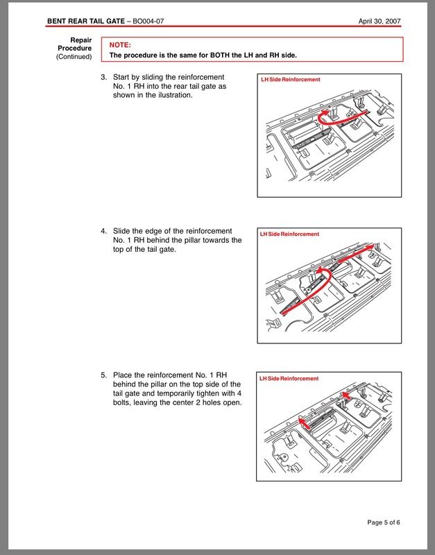

    Quote Originally Posted by Moto26 View Post
    Interesting...
    I wondered why I never got the TSB, but then I realized the Ducatis were 2008 models, which we picked up in 2007. We got His and Hers bikes the same day, and I was riding mine home as my wife drove hers home in the truck. After my tailgate turned into a "Taco" (see what I did there), I went and traded it in sometime in Nov. of 2007 - almost exactly when the TSB was issued. Ha!
    Anyway, looking at the TSB, I'm not sure what it actually consists of. Just the top edge protector, maybe a little stronger? When you remove the plastic liner, you'll see what I'm talking about. Here's what one guy did to strengthen his...
    Attachment 58225
    He added in some heavy steel square tubing to reinforce the tailgate. You can see how there's nothing there but AIR to hold up your bike. Honestly, I don't even know how the truck survived hauling a bike even once! I still can't believe Toyota green-lit that design...
    Okay, I'll try not to jack your thread any more, Guitar...
    No problem! It looks like the TSB had included installing a reinforcement inside the gate, like you had done to yours.
